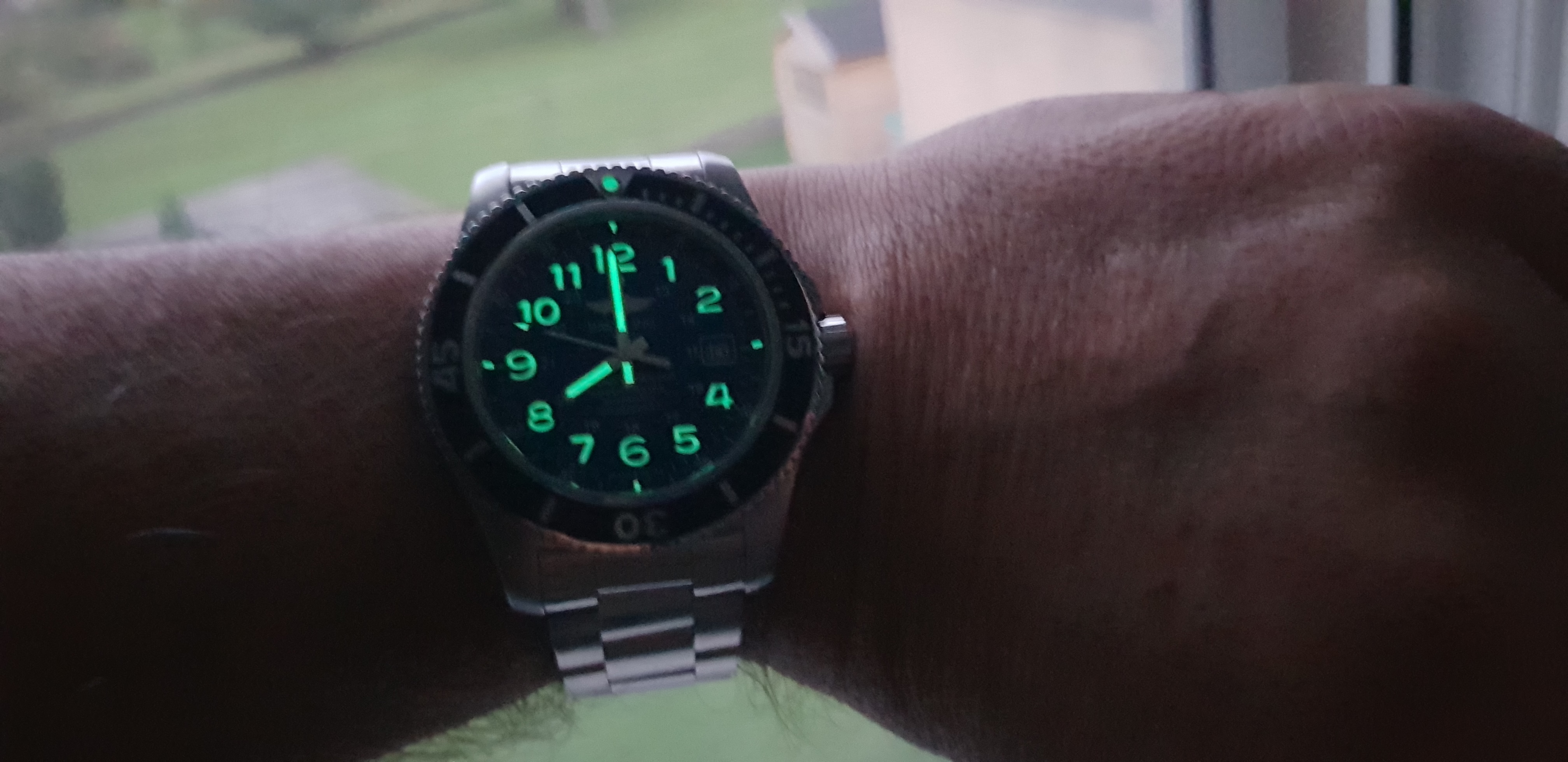

    #420004140178
    Valentino67
    Feu de Super Ocean - Volume 4 - Page 29 8u6j
